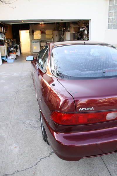

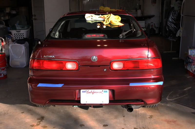

Here's some more of the detail shots

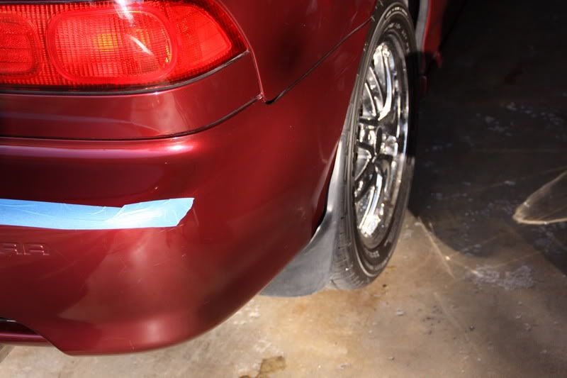

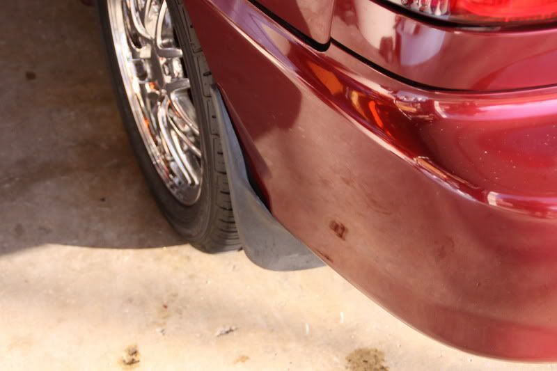

A couple during detail shots..the tape is on the rear because thats where the paint is falling off haha. if i hit those areas with the PC...well you know
94-97 Mudflaps on 98 bumper = fail
Can you picture whats wrong (aside from the obvious misalignment of the trunk to qtr panel)?
Give up?
So I took it off and painted flat black.
All done!
Notice the mudflaps fitting correctly now..
DB Squad
Integra Forum Moderator

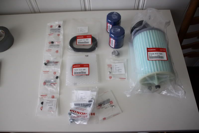

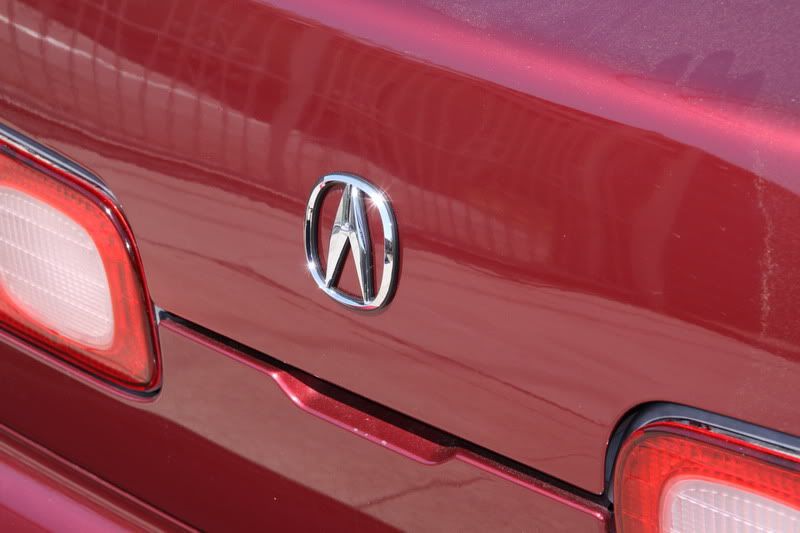

Yay new parts

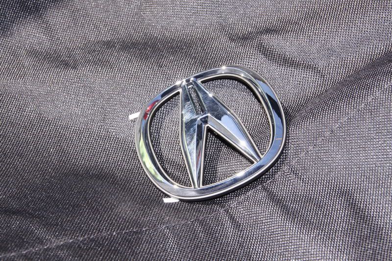

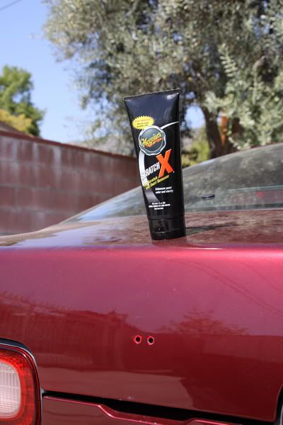

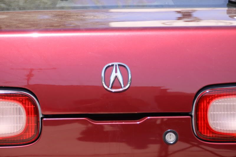

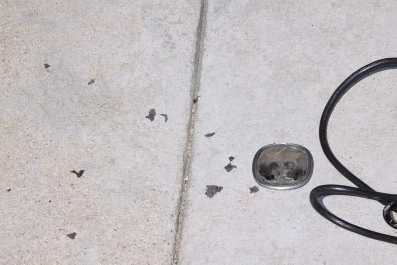

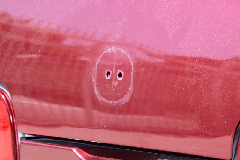

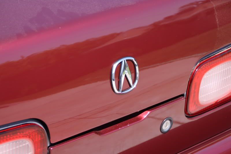

I didnt take pics of the emblem glue once I pulled the emblem off, but it wasnt too bad to remove once heated with my heat gun.
Glue remnants
At least it didnt pull ALL the paint off (notice the specs of red around the two holes)
After Scratch X with heavy pressure and by hand. There were some deep scratches that I couldnt get out though. oh well..
New Emblem
Installed!
It isnt perfect, but at least I wont be confused with funny rice mods.

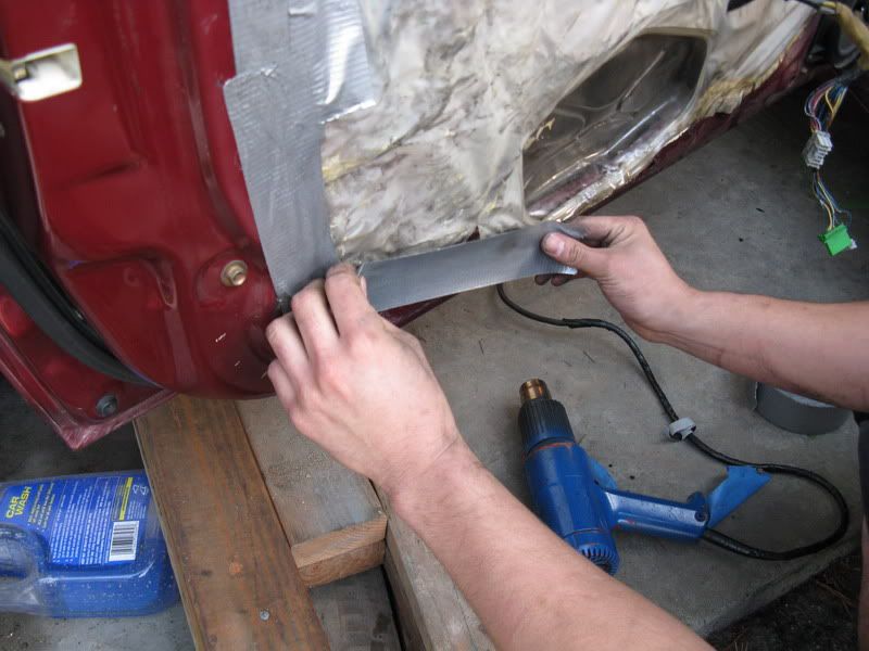

Heres some old shots i never uploaded...

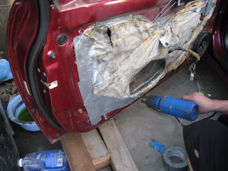

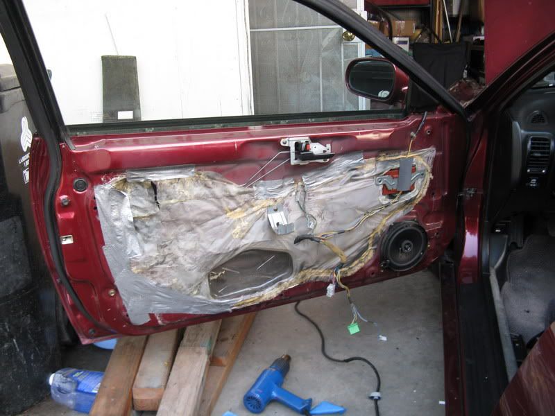

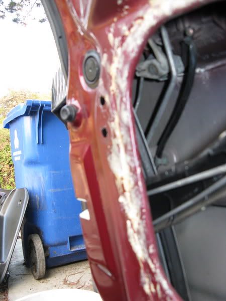

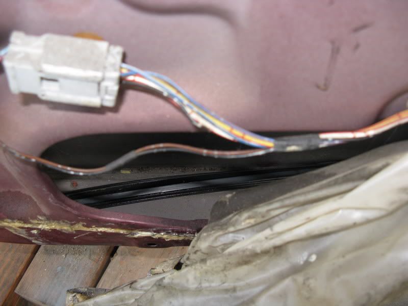

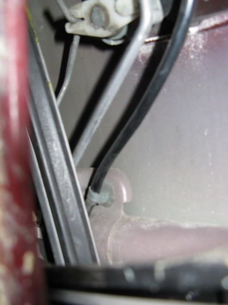

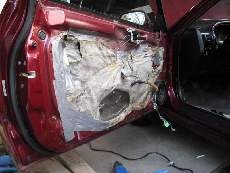

Ever wonder why your door/car makes a horrendous piece of poop sound when you close the door with the windows open?
Here we go...after removing the door panel. eww, look at that wind noise barrier (the plastic)
The culprit
Dont see whats wrong? The rubber track tends to fall out over time.
Lets put it where it belongs.
Alright. lets be creative and get that wind barrier back on the door...excuse the ghettoness haha (props to HT DB Squad leader for the install/repairs haha)
So why didnt I just buy a new one?
http://www.acuraautomotiveparts.org/...s=&view=normal
I didnt want to pay 30 bucks (w shipping) for it.
DB Squad

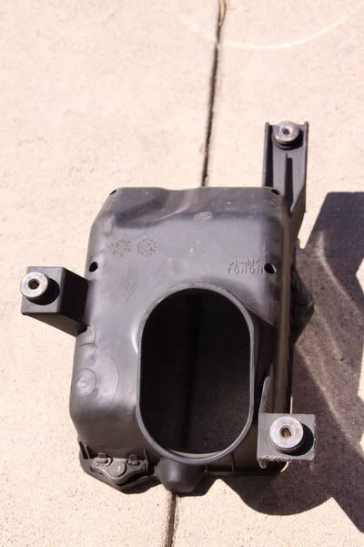

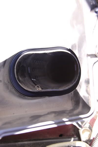

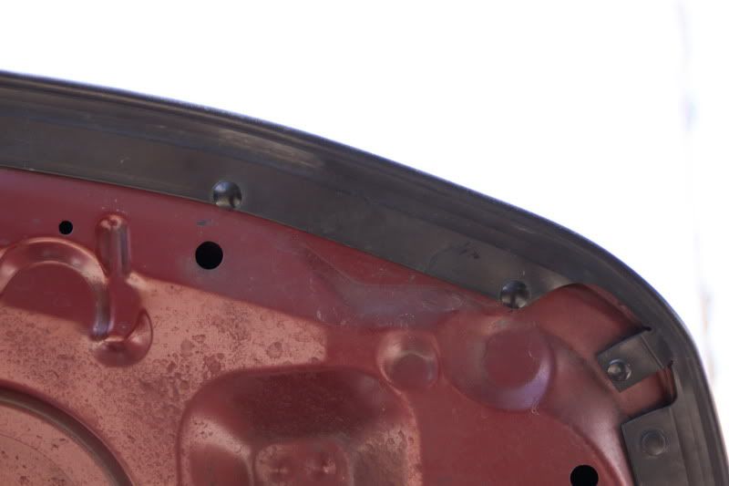

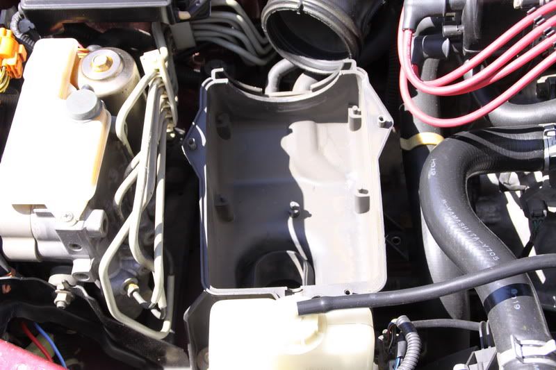

Missing hood molding clips.
Not anymore
Of note: Only two bolts holding down bottom portion of box. top portion is missing screw, but not important enough to bother me. The bottom ones are more important because of the engine movement.

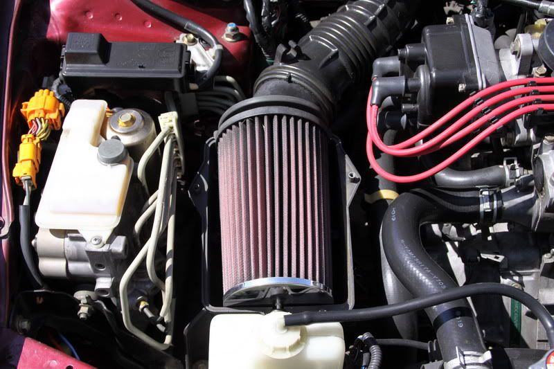

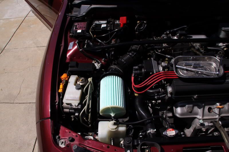

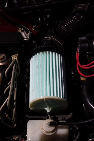

Top cover off - For some reason the K&N filter base is larger than stock, which is why I couldnt use the little spring/clamp at the end of the hose. Maybe I'm just too weaksauce.
When I modified the resonator box a couple weeks back, I noticed the bottom of the box was missing a rubber seal that isolated the intake air from the underhood compartment
Now its isolated - factory cold air ftw haha
Filter in - notice spring/clamp on intake hose
All done and bolted down
DB Squad
