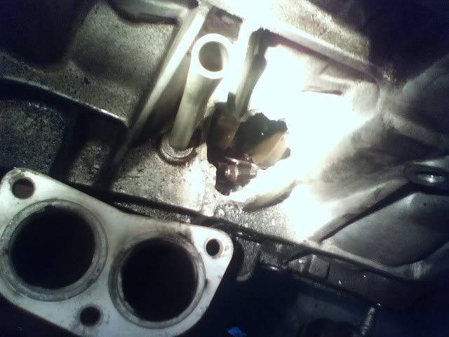

i threw a rod and busted a hole on my gsr...i came across a b20 block for dirt cheap...so i decided to pick it up...it has a crack in between cylinders 2 and 3...i plan to resleeve it for sure....with forged internals...good cams for my set up ...and valvetrain....i'm just not sure of what crank to use...should i look for the b20??? or what??? my plan is forged rods...pistons....with a good cpr for like 150 shot of wet nitrous...what do u guys suggest???? i have money in hand that i was going to spend on my gsr.....so...now i am gonna spend it on the b20...

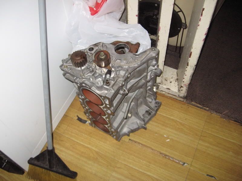

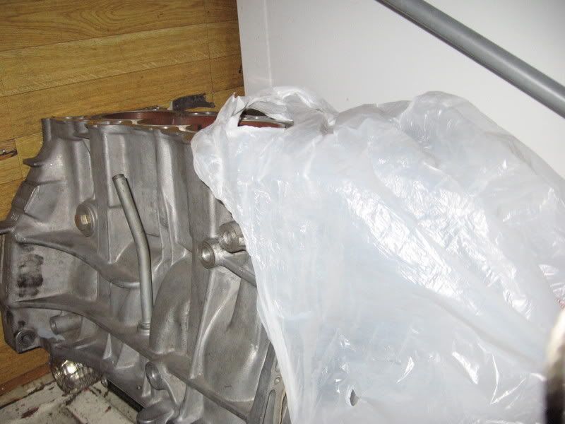

so i want opinions on this set up....i plan to daily drive it (like 10-15 miles daily) and take it to the track on the weekends...so with a good tune, valve train and c/r...150 wet shot...what #'s would i be looking @????
heres a pic of the block that i just got...
