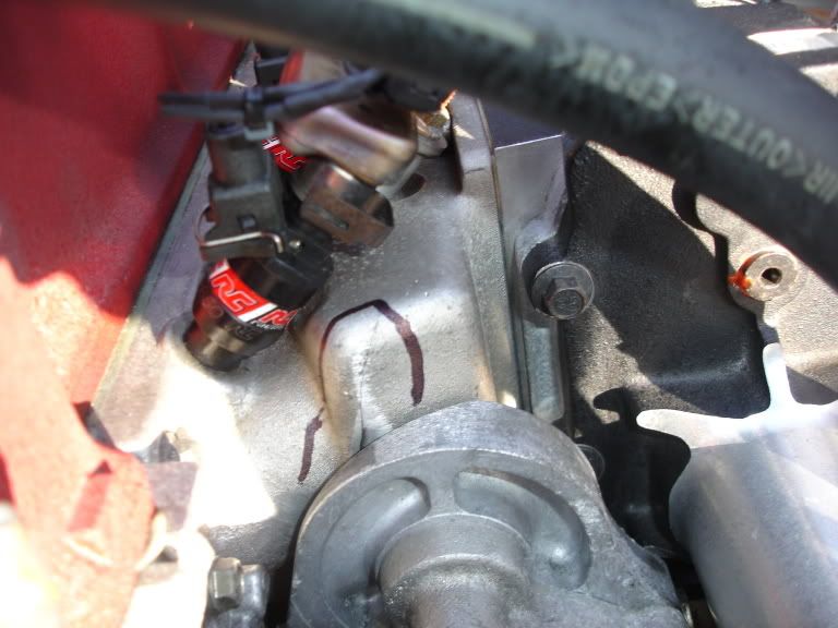

Hey guys,
I was wondering if anybody Stateside had expierenced problems with
JRSC inlet manifold, mine developed hairline cracks, I subsequently had it
removed and repaired, a few months later they have re-appeared but worse.
For the time being Ive used Araldite to smoothover the split, untill I get a new
one this time, but I dont want this to keep happening, Has this happened to anybody you know and I wonder what JR's take on this matter is???
Ps this is the first time it happened.

Mate,
did you have JR or thier subsidiaries repair the crack? If you cant get it fixed through retribution, then id try deburring the manifold and repairing it with Devcon. Just for the record, its not the manifold that leaks castor bean oil its the blower case.

Originally Posted by twinring
Mate,
I have not noticed ant leaks, yet...
I had a fabricator friend repair the crack, drilled out and welded.
Im going to buy a new manifold.
Just wanted to know if others had suffered this problem and if it was common, If so I'd be worried, maybe I just got a bad casting?????????

Anyways do the newer kits have a support under the manifold thats alot of weight hanging out over there.
