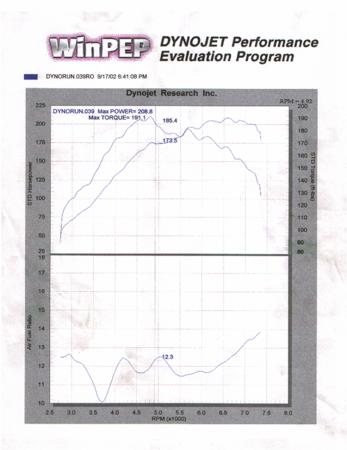

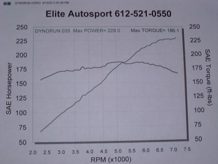

A properly sized turbo will not have any noticible boost lag, however the torque does not come on instantly. A JRSC lude will have about 180lbft tq at 3k RPM and remain constant, a turbo lude will be stock at 3k rpm, but might have a higher peak tq. Take a look at the dyno's i got my hands on, both at 6 psi:
Turbo setup:............................................ ...............SC setup:
(dyno's taken from a dyno library at www.preludeonline.com, PM me if you want them taken down)
take note that at 6psi, the parasitic drag from the SC is neglegible in the dynos. Granted with much larger blowers (the M62 is a REALLY small blower) the parasitic loss would be a big factor. What I wanted everyone to see is that at 3k RPM the turbo at 6psi (not spooled) was making 70ft-lb, while the JRSC was making ~150ft-lb
