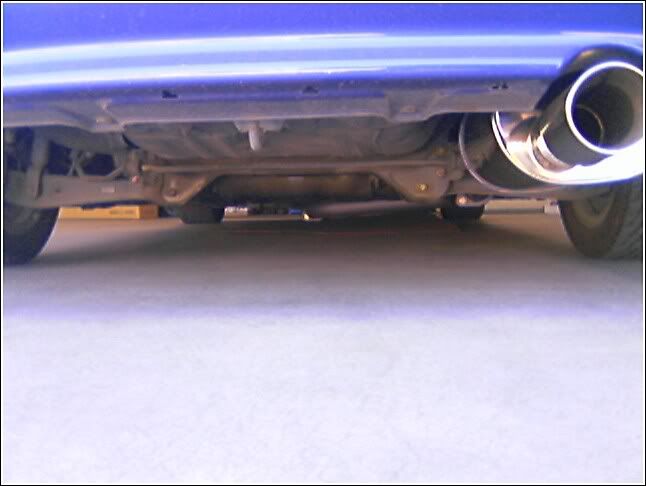

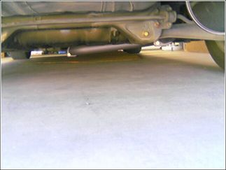

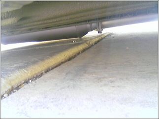

Hey, I just got my Apexi ws catback installed. I was just wondering is the pipe underneath my car suppose to hang lower than the stock? It hangs about an inch lower than the stock one. Can it be a missing hanger or it was made that way? Plus my car is lowered so that makes the problem worse cuz i scratch on anything that has bumps or dips. Does anyone else have this problem with their exhaust pipe scratching? I'll try to post up some pictures to give you an idea on what's going on.

wow that sucks, jack it up and put it on stands and see if your missin a hanger, sry to see that

Nope...everything is there. It just hangs too low...i think i might have to get new springs and bigger wheels (which i doubt it works)

Not sure what kid of car u got but I have the ws2 on my 94 accord and that shit hangs real low too. Its just poor design I guess. Im also lowered on h&r sports and I scrape going over some speed bumps but its not that bad just go slow and diagonal.

this may sound dumb, but make sure you don't have the midpipe after the cat upside down... its possible to do this, as funny as it sounds. The hangers will face the wrong way and your midpipe will hang super-low. The hangers on the midpipe should be facing down like this ...
