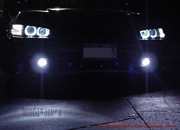

well its been a while since i have posted anything worth damn...but as of late my car has been pissing me off...frist just to refreash everyone i drive a 95 civic hatch si, anyway is there a way to fix the halos on projector headlights mine seem to have gone out ,actually they started to flicker then they went out. please tell me if this can be fixed. Oh one more thing, please don't flame me but, can one of you nice folks tell me how to install a oil pressure gauge thanx.:thumbup:

can't you just replace the bulb? Or is it an LED? I don't have any expreience with halos (won't go into my thoughs on them in this post...). If it's an LED, you should be able to get another one from RadioShack or something... :dunno:
MaxBoost has halos doesn't he?

there are leds
Hi :wavey:
Ricer-Roni
They are in fact LED's.
First, I would suggest you check your connections, usually one or two wires may come loose during driving.
If that's not the case...It might be a pain in the arse to fix them.
The LED's, when I took the headlights apart, are glued into the Angel Eye halo. I believe there are two... it might not be possible just to swap out the LED. But I would be sure that it's not to hard to just piggyback an LED on the ring itself.
You would have to take the headlight housing off the car... then heat the glue that is holding the headlight together- then pry it open.
