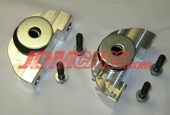

the weird thing is the motor mounts are ok. the one I thought was messed up isn't. and when I put them back on the motor seems lined back up right. :dunno: the cushion mounts are torn all to hell so I'm going to replace then with some billet torque mounts. but I plan to make those :rick:

HASport mounts or bust. Fuck inserts, fuck torque mounts.
yeah, the inserts are a lil ghetto. they work great while they last. the mounts end up tearing themselves to pieces. there is a company on ebay that sells life time urethane mounts for like 130 bux. from what i can tell, they look exactly like innovative steel mounts and use a hard compound urethane. check them out if your on a budget, ive been considering picking up a set.
and the torque mounts do help! i wouldnt buy billet ones, maybe just the inserts with window weld. or just fill them. having the torque mounts isnt going to hurt, only help

hmm there's a guy selling hasport(?) knock offs for 100 on ebay. I might try those. Lee are you sure you're not thinking of the torque damper? I'm talking about this
no way in hell I'm paying 100 for a couple of blocks of aluminum that I could mill out in an hour. I'm just going over to a friends shop to whip them out.
